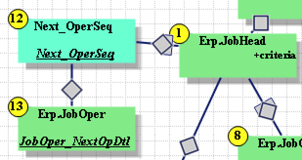

I’ve got a query that returns various information about open jobs. For each job I want to display a couple fields from the JobOper table for the MIN(OperSeq) Where OpComplete = 0. I have the Where clause working via the criteria on the JobOper table, but can’t figure out a simple way to select only 1 JobOper row per job - the row with the MIN(OperSeq).
I can get this to work via a subquery that displays the min OperSeq (and company/jobnum for joining purposes), then on the top level I join to a second copy of the JobOper table to the subquery so I can display other fields in the row(OpDesc, StartDate, etc) but it seems terribly inefficient.
Any pointers for a BAQ newbie?
