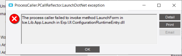

I’m trying to launch a configurator form in Part table on a button click. I tried the below code but its giving an error.
ProcessCaller.LaunchForm(oTrans, “PR000006”);
I have already checked similar post but did not get any soloution.
There is no solution because there is no way to call configurator from Part Maintenance. It can be hosted from: Engineering Work Bench (Get Details), Quote Entry, Job Entry, and Order Entry.
