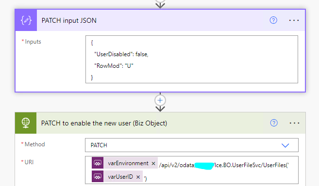

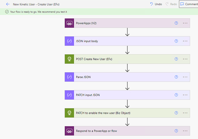

Well, eventually the lightbulb clicked - I don’t need to enable the user in the Function. I can call the BO directly, since I know that works.
So, it needs some polish, and I’ll write it up in a separate post here, but this works in 2021.2 and 2022.2:
