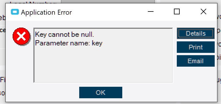

I have an epiTextBox control on the A/R Invoice Tracker screen which I’m filling with a value that comes from a DynamicQuery. It is being populated correctly. I want to be able to right click on that and Open With. I set the EpiContextMenuKey to UD21.Key1 and UD21.Key1 is defined in Context Menu Maintenance. But whenever I right click is pops up an error.
I’m running a Dynamic Query, which runs a BAQ to find out which UD21 record that Invoice Number is part of. It passes the invoice number and returns one UD21_Key. I take that key and set the epiTextBox.Value to it. It displays the correct value, I just can’t right click and open up the maintenance screen from it.

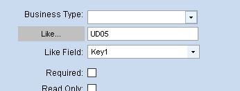

Even after binding a txtbox to UserChar4, and setting the epiContextMenu property, I still needed to go into Extended Properties and set the Like and Like field for UserChar4 on my table.
Edit #2
With the extended Property’s Like values set, you don’t need to set the epiContextMenu property on the form’s control.
