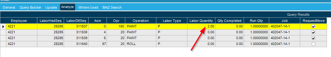

So I am able to end activity with my code in the dashboard and I can set the quantity using the value that I type into the dashboard.
Now I need to add some cell validation in. I don’t have any experience working the arguments and the properties so I am getting stuck. The code that the wizard gives me is shown below.
	private void Results_AfterFieldChange(object sender, DataColumnChangeEventArgs args)
		// args.Row["FieldName"]
		// args.Column, args.ProposedValue, args.Row
		// Add Event Handler Code
		switch (args.Column.ColumnName)
			case "LaborDtl_LaborQty":
			MessageBox.Show("edit intitiated");
			break;
I’ve added the message box to see when it fires, and the message box pops up any time I tab out of the field, so that’s good. I can also add in args.Row.CancelEdit(); and it will cancel the edit, which I will need later.
What I need to do is compare the proposed value to (RunQty - QtyCompleted), so if the labor qty is more than what is actually left to make, it stops them from putting that value in.
I can see the helpful properties that it provides, but I can’t figure out how to use them. I’ve tried putting this in right after the message box. It compiles successfully, but it kicks out after hitting the first var. If I comment out all of the var and the if statement, it will show both message boxes. (I’m skipping the extra math for now, just trying to get some if then statement to work)

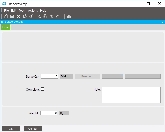

What I am wanting to do is create a form in MES which looks kinda like this:
And then have it create a time and expense entry (laborHed/Labordetail) record in the same way that one would when entering a time and expense entry as below. The circled items would be entered by the employee, the purple squares are entered by context, and the red squares are set regardless.
