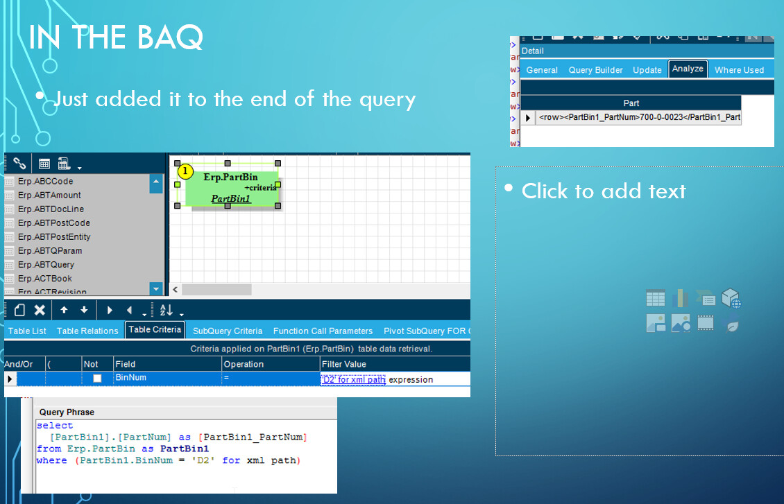

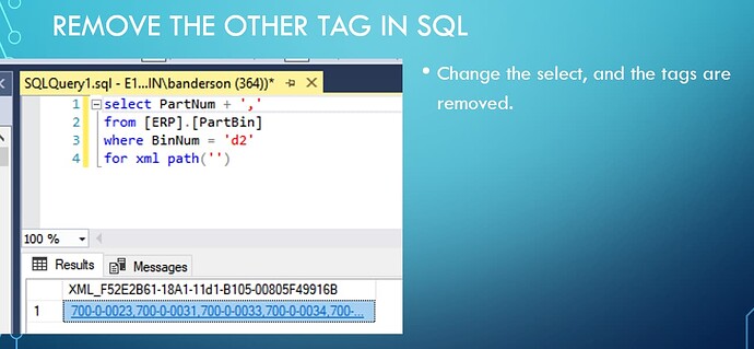

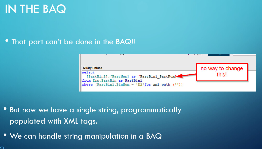

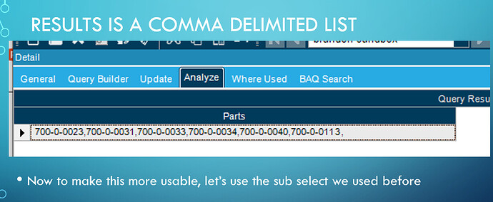

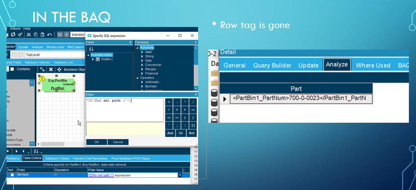

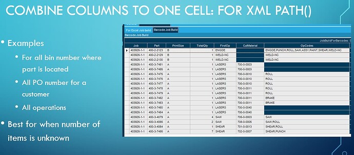

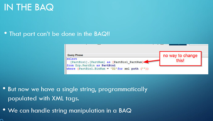

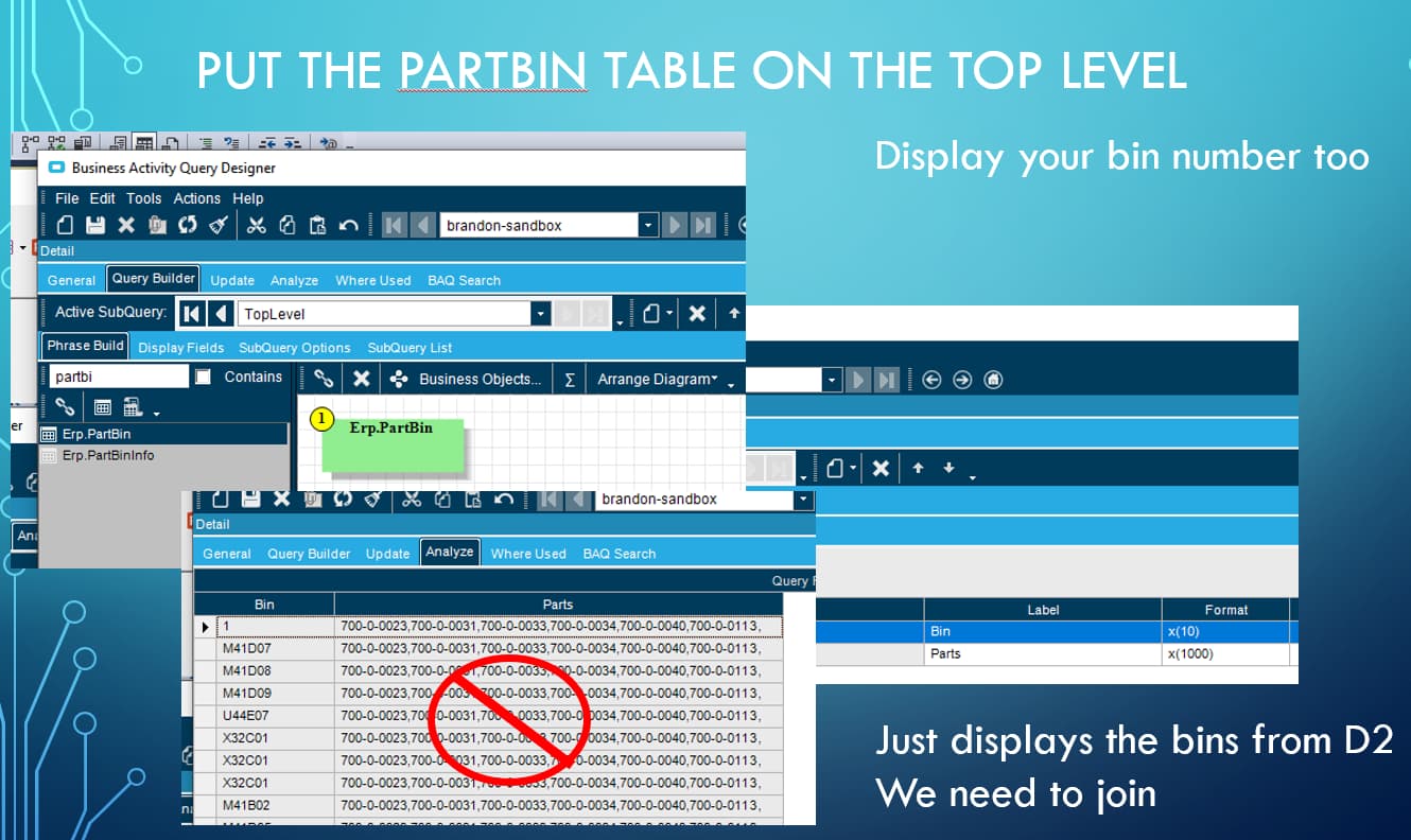

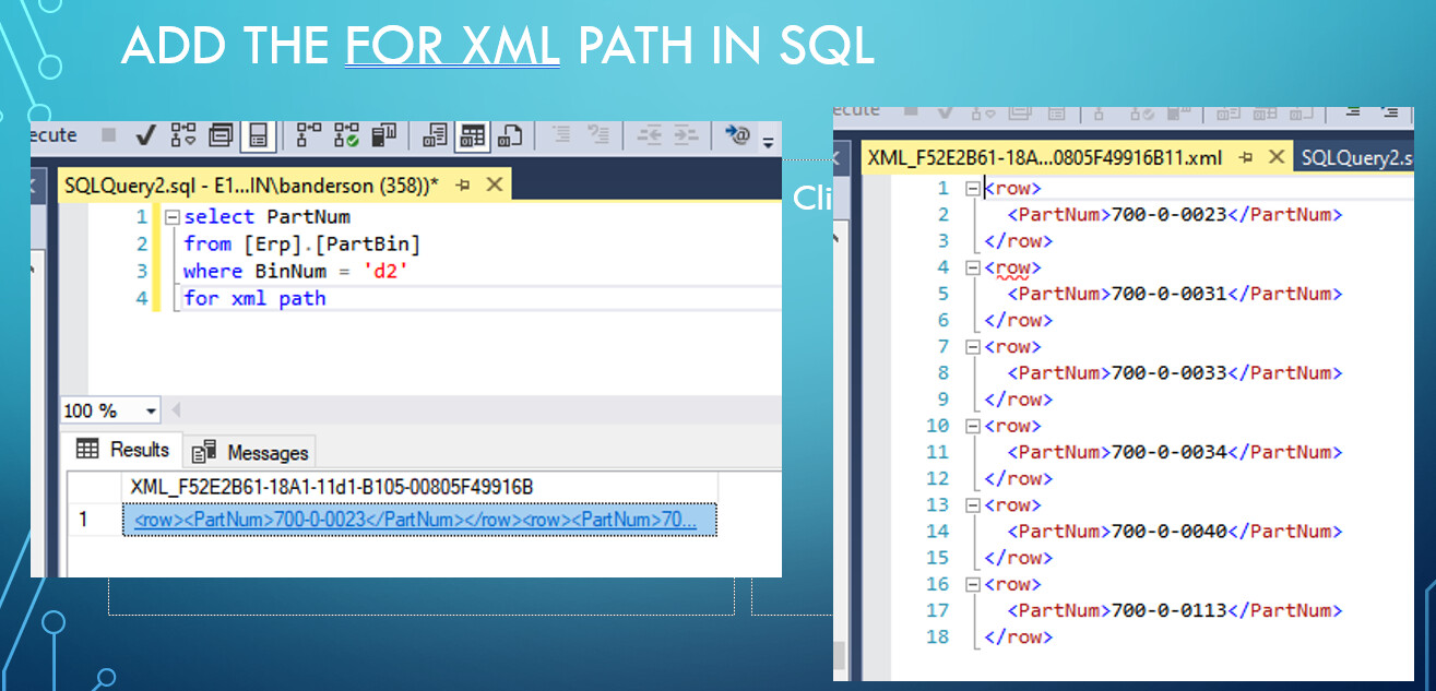

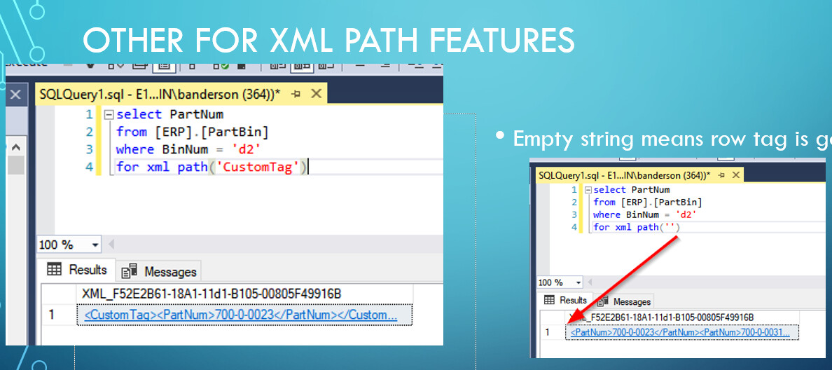

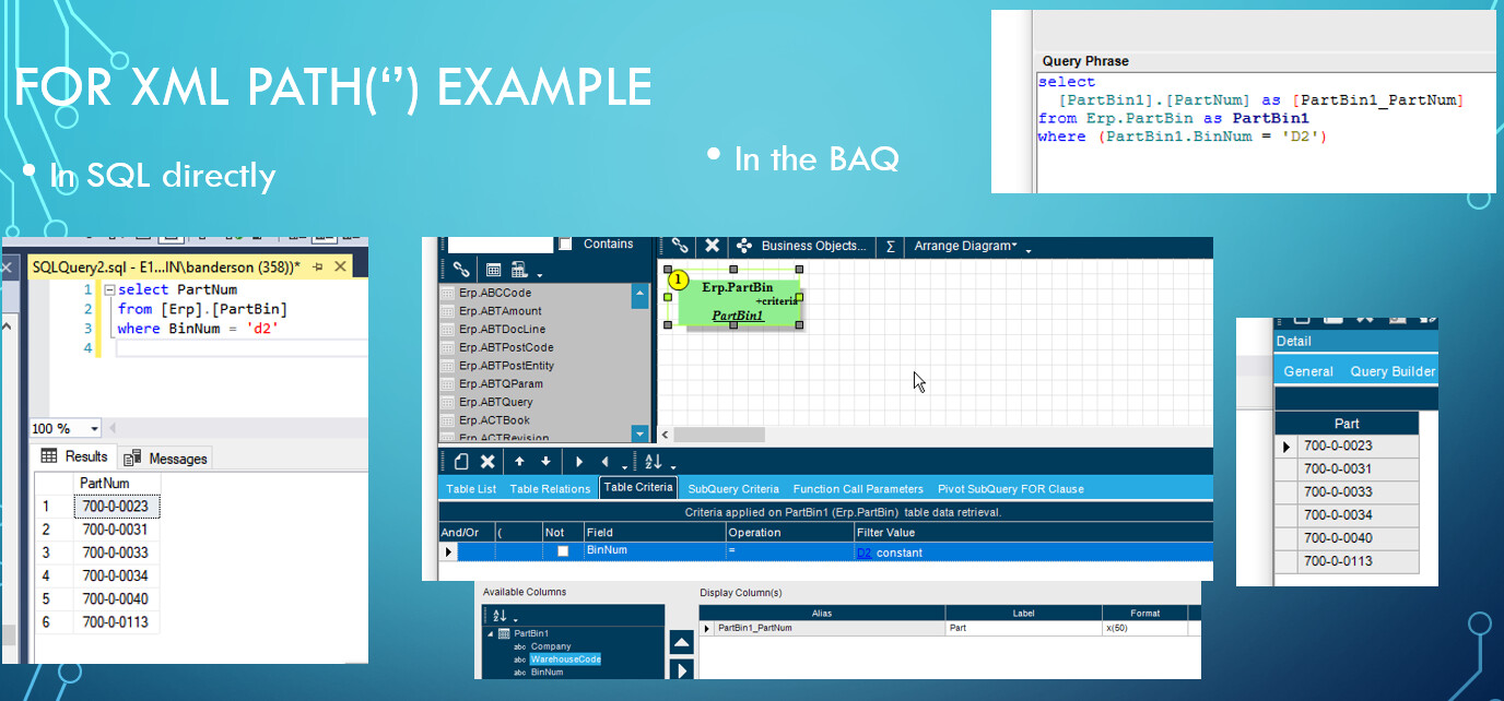

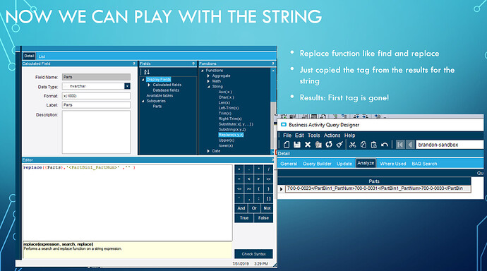

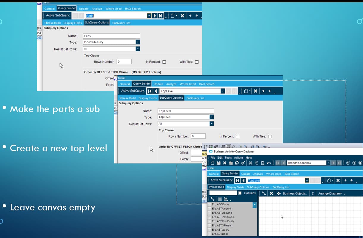

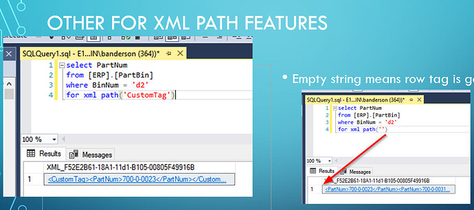

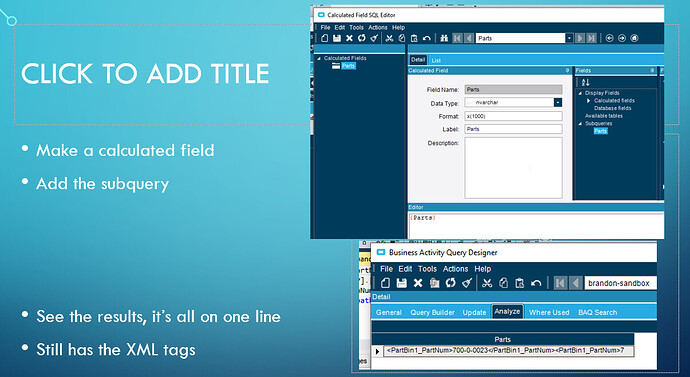

This is a presentation I did on “For XML” years ago. I’m supposed to be narrating, so I’m not sure if you’ll be able to follow everything, but it’s how I build the query.

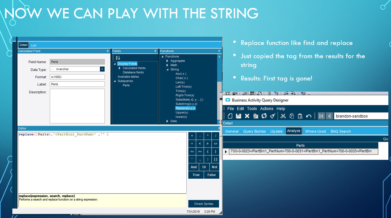

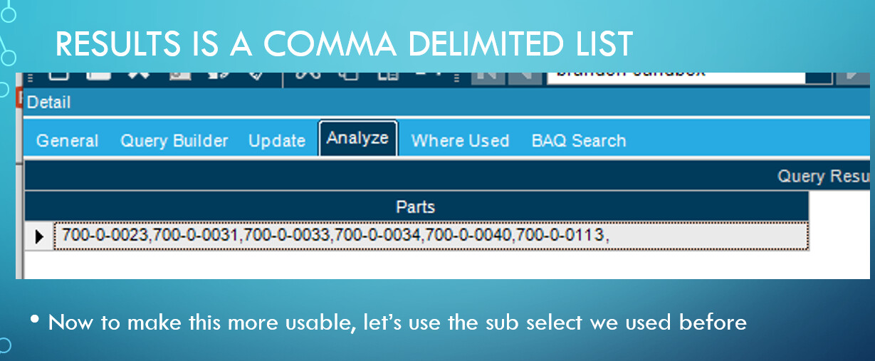

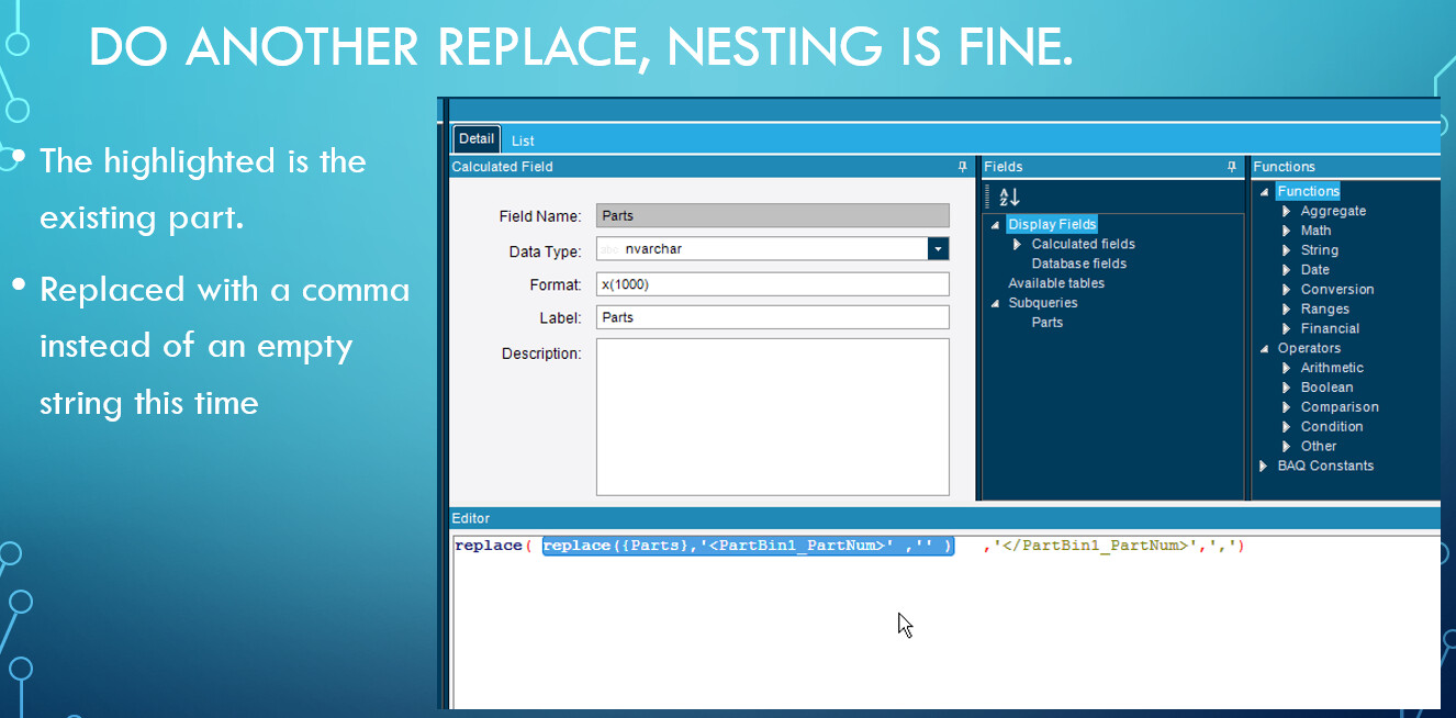

The key takeaway is this. For_XML() is a function that’s used to shove all the rows into an XML text blob for something to read. So, it just takes your whole query (or subquery) and shoves it into one cell. It has all of the XML tags because that’s what it’s for. The rest of the “Complicated” stuff that we are doing is for string manipulation to get the XML junk out of the way.
there’s another slide with a video that’s too large to upload. But basically I add the joins in the subquery criteria for a single sub select.

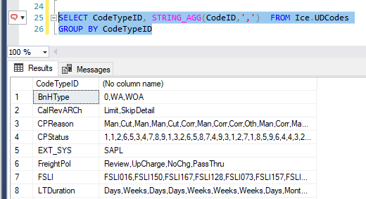

Start with another (brand new test) query so that you understand how the string agg works. Do you have any user codes in your sysem? Make a query on the UDcode table. Display the CodeTypeID and group by that field. Then make a calculated field with string_agg(CodeID,‘,’).
Once you get that to work in your test query come back and we’ll go from there.

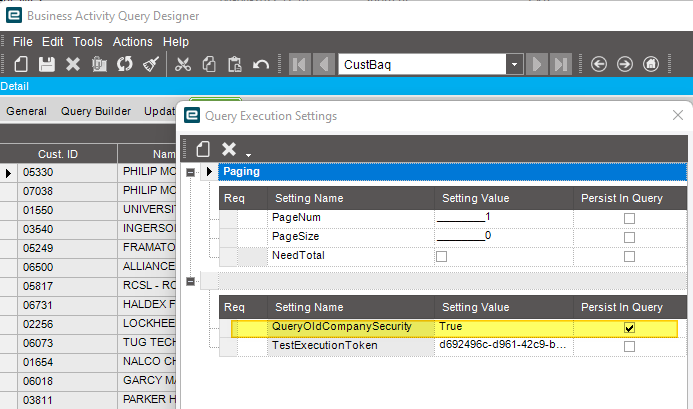

Try to add this setting:
