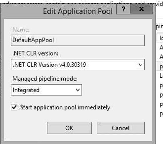

One more thing to check. In IIS make sure the application pool for the Help site is actually running. I have seen instances where this is stopped, and while it does not affect Epicor typically, it does make help appear as not working.

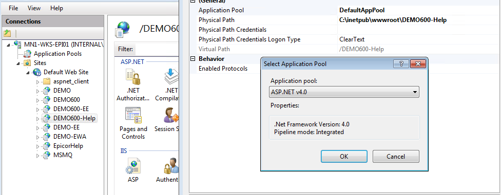

I think it might be the application pool you are using. Can you see if you have the same option, as the screen below, to switch the application pool? I would try switching it.
Not sure I follow how you got to that screen. Is this correct?
That looks correct. I assume it is not stopped as well. Do you have anything in the Event Viewer when you attempt to access Help?

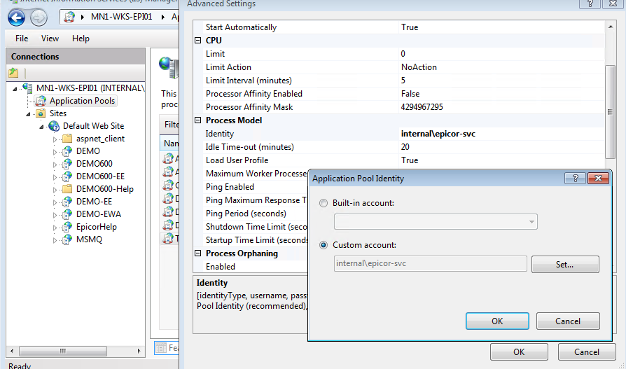

So I am not 100% sure of this but I just created a new help install using a custom account like you did and it does not work for me. I went back to not using the custom account and it worked. hmmm. Further updateā€¦ Not sure why it did not work as I switched it between URLS (help wth no account and help with account) and it worked.
But if we already have it installed, then how do we uninstall it to then set it up to not use a custom account?
You can go to IIS and change the application pool (advanced setup) to use a Built-in account. If help still fails after changing you can use this to switch back to a custom account.
