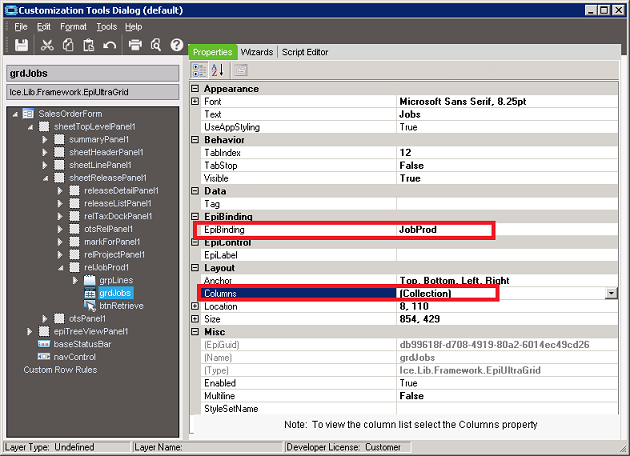

JobProd in Order entry looks like it is a Collection

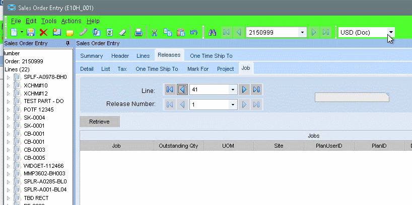

Just as a follow-up, you might be missing the fact that the JobProd dataset will only be populated when a job is selected.
In the GIF below I Customized Order Entry -> Releases -> Job tab, to include a field bound to the JobProd.JobNum field. It only is populated when I select a line that has releases, that has jobs. Which means the dataset containing the JobProd record requires some context to know when which JobProd record to select

That context is accomplished by via the EpiControl values:
