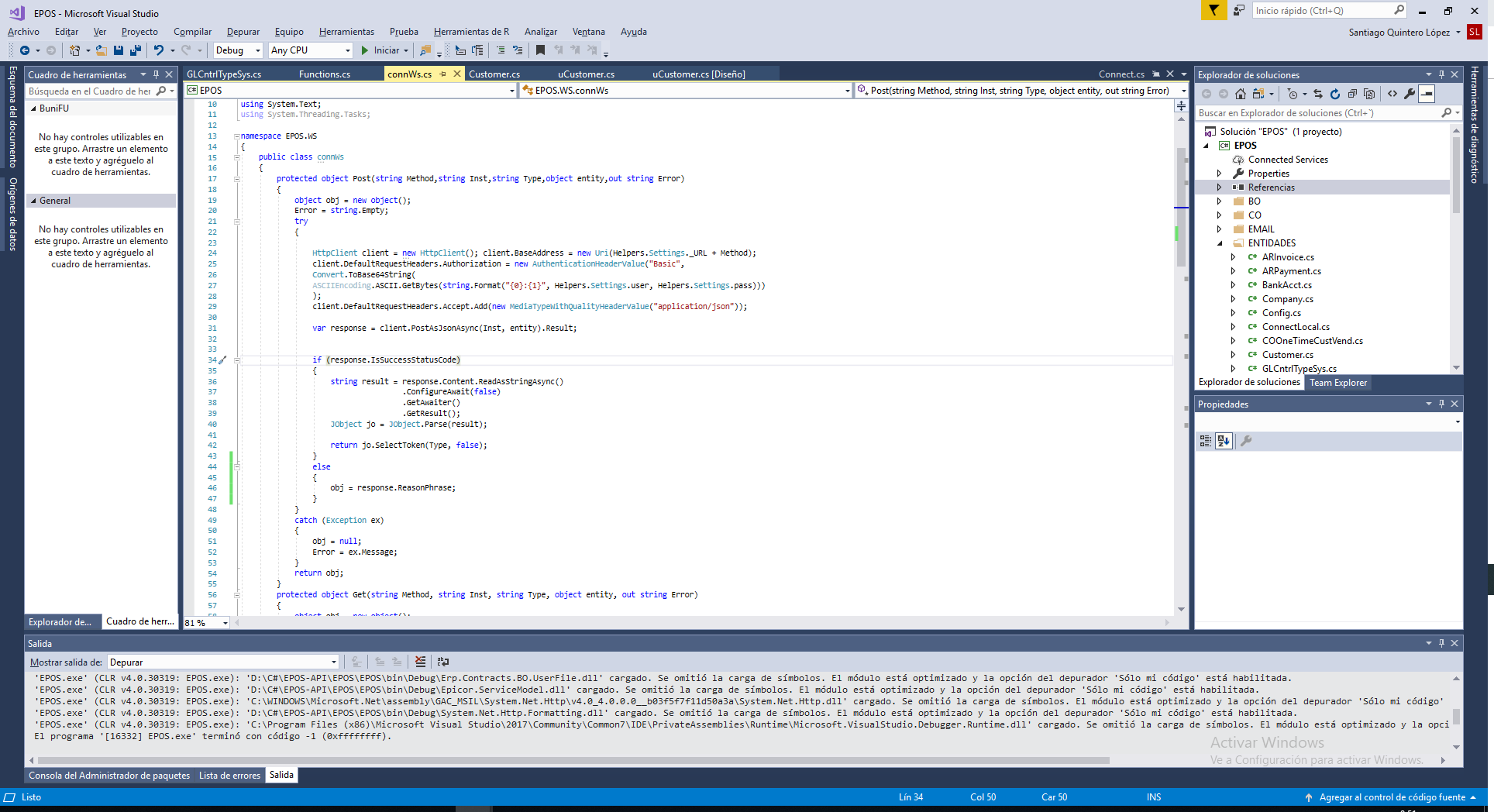

off course,
I have a method that receives an entity with the custNum field, to do the getByID
I update the tableset that the GetByID returns with the information I need
when I run the update parameter, I send the modified data to an entity of the CustomerTableset type

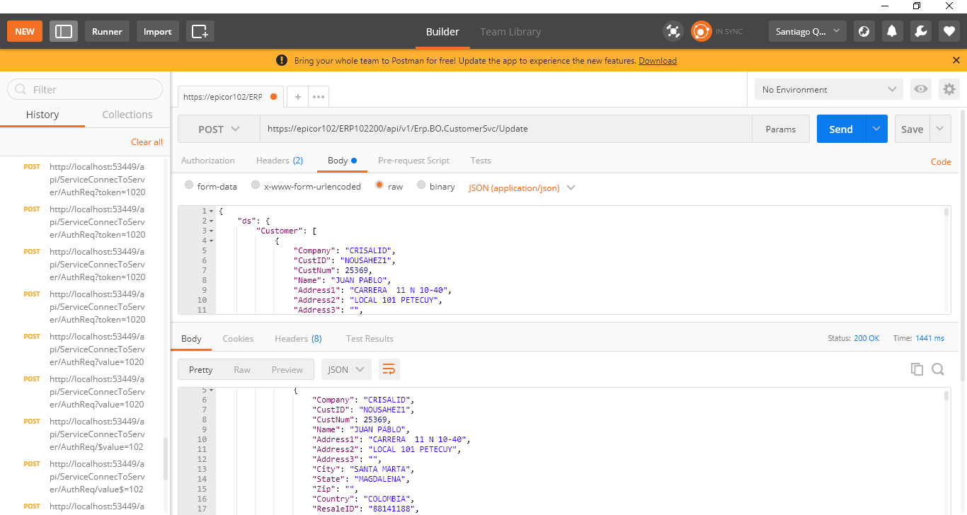

Are you able to make the same request via postman? That error message makes me think something on the service itself limiting the size of the packet but I can’t imagine it’s that large…hmm

Ok so that tells me there’s something in your application limiting the size of the content allowed to be posted. Are you calling the Epicor API directly or are you calling an internal API?
Epicor API directly
Length: 1948410

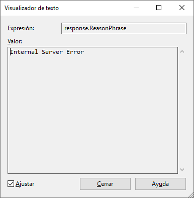

change the uploadReadAheadSize to 2147483647 and the error message changes to Internal server error
