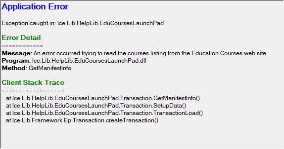

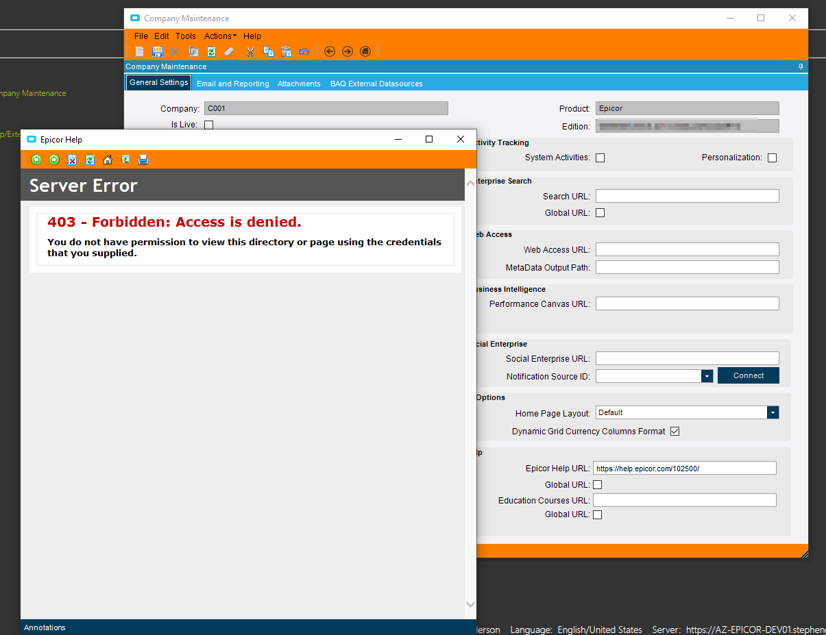

@hkeric.wci - ok, so I tried this new URL in the browser and it looks much better, but the APP certainly doesn’t like it any better :frowning: It still says no permission…
And it seems to be Education as well… https://education.epicor.com/102700 get’s a different error…
You suppose they pass a header in the request from the Client that’s missing from the web page? :thinking:
Yes. The help files don’t work unless called by the client. Even hosting your help files, loading them with a browser gives you a notice that it can’t run.

Did you ever figure this out @MikeGross? I’m getting the same thing that you are, and it doesn’t matter which URL I put in there. It’s the same 403 -forbidden message that I get no matter what.

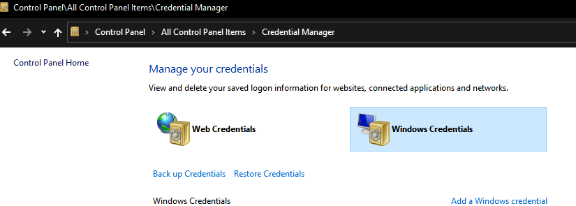

You might need to go to Control Panel and clear any saved credentials for
https://help.epicor.com/102500/
I don’t have any creds stored for help.epicor.com. Any other ideas @hkeric.wci

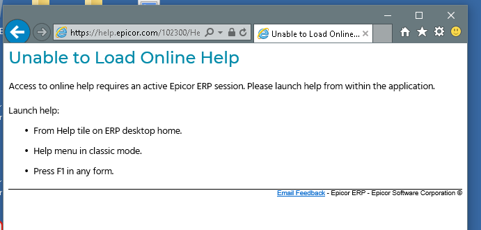

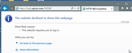

  1. RDC’d into WS, launched a browser (IE 11), no E10 clients running
    a. Help URL yields a 403 Error (the following is the IE11 generated page)

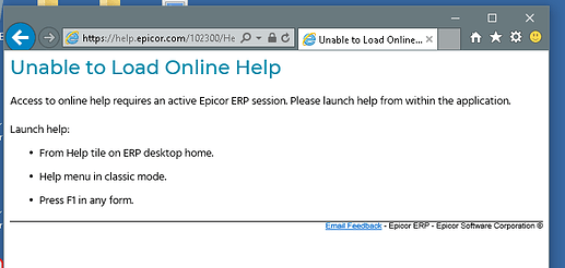

    b. Help URL with /Help_NoAccess.htm yields:

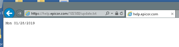

    c. Help URL with /update.txt yields:

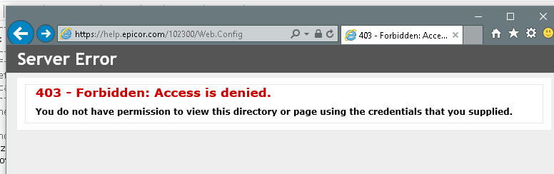

    d. Help URL with /Web.Config yields a server generated version of a 403 error.

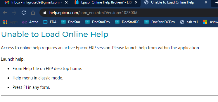

  2. On Home Laptop, launched Chrome
    a. Help URL yields a 403 Error (the server generated format)
    b. Help URL with /Help_NoAccess.htm yields a 403 Error (the server generated format)

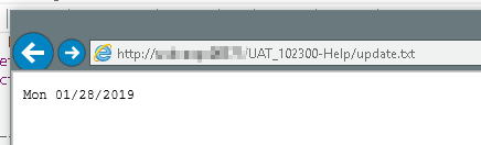

    a. Browsed to hosted help URL http://App01/UAT_102300-Help, got server generated 403 msg
    b. Browsed to hosted help URL with /update.txt and got:
On WS, trying URL https://help.epicor.com/102300/enu/Standard/
redirects to
https://epicor-help-prod-102300-westus2.azurewebsites.net/enu/Standard/
And gives the “Unable to Load Online Help” page (similar to /Help_NoAccess.htm)

One last thing, the Help URL (adjusted for version) with /update.txt returns the following:
.../102300/update.txtMon 01/28/2019
.../102400/update.txtFri 05/10/2019
.../102500/update.txtSat 02/01/2020
.../102600/update.txtWed 12/16/2020
.../102700/update.txtTue 12/15/2020

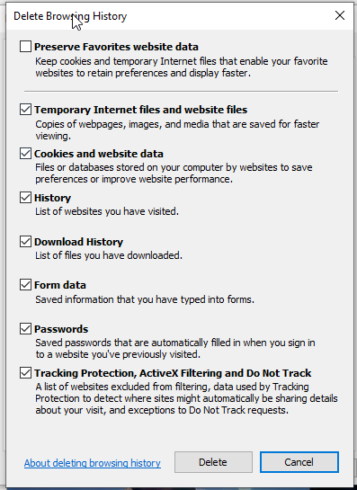

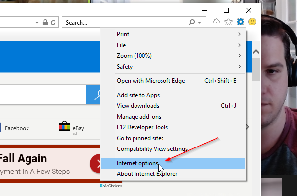

I opened up internet explorer (like the old crappy one) and cleared the cookies out of there. That fixed it for me. To find that out we used fiddler to see which browser it was using. (why it took us so long to figure out?? I don’t know)
open Internet Explorer
Go to Internet Options
Click Delete
Check Everything Except the First Option
Click Delete at the Bottom
Close IE, Close Epicor Completely and try agani.
