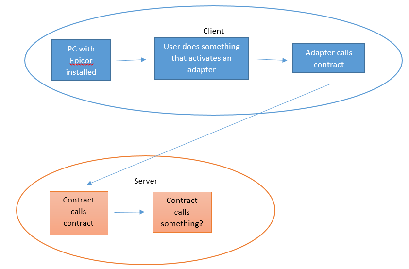

Right separate Data Tables like RDD’s do
This is a VEEERY simplified view… but this is what happens (roughly)
Client Front End -> Implements Adapters -> which in Turn implement Service Contracts -> which are the Contracts to the WCF Services -> Which perform the back end logic…
For Example
User Opens Customer Entry and Types in a CustID which triggers a call to GetCustomerData in the Transaction object instance of the Customer Entry Form
That does some VERY basic checking (or a LOT of checkig depending on the method), sets the status bar to “Retrieving Data” then it calls the Customer.GetByCustID
It , in turn does some basic checking as well, it sees if you have implemented a BeforeAdapter call and if so it executes that code (Customization Layer) and then calls the service contract for the Customer.GetByCustID
The GetByCustID Contract makes a call across the network to the Customer.Service hosted on IIS
This Service responds and runs the call through the Customer which is used amongst other things to trigger BPMs and do a BUNCH of other stuff, the Facade eventually invokes the Customer.GetByCustID method
which actually contains the business logic to get the Customer Data…this method runs several DB commands and stored procedures to get back the Customer Data that you expect and it returns it back… the sausage un-rolls the same way it was built… Data is passed back to the Facade, and then back to the Contract across the wire and then Back to the Adapter and eventually back to the Transaction where a bunch of forms events are triggered to let the UI know they now have data.
and… that was a lot of typing hopefully that makes sense and hopefully I didn’t miss / mis-speak anywhere, forgive me if I did I am doing 32 other things.
