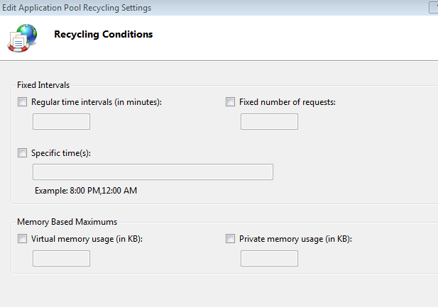

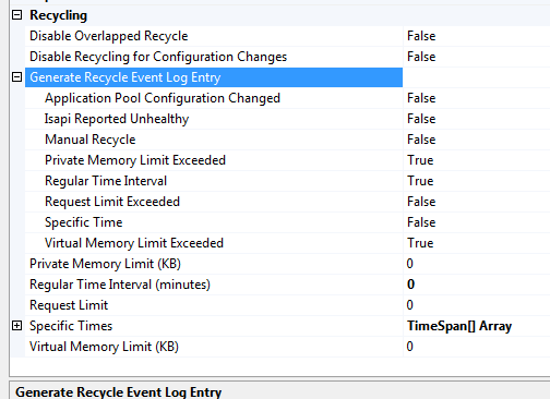

I would still look at when and why your pool is recycling. There are usually throttles on app pools that cause it to recycle. If you have a memory leak for example, it may be recycling when you don’t want it to recycle.
Turning on logging as to why it is recycling is a good idea too
