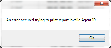

I put a MessageBox before it to show the AgentID mine pulled. It was ‘TaskAgent’.
I also had a MesageBox after the line and it told me it was ‘SystemTaskAgent’.
Then it errored out with:
Why did it change it if it was not empty?
I know it was typed correctly because it was a straight copy from here.
So you are saying if agentID had something in it before this line of code, it should change it to be SystemTaskAgent?
Why should it do that?
