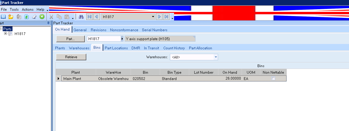

Check the Bins tab of the tracker; it really should be there even if it isn’t right in the other tabs. Sometimes there are issues with Epicor and conversion 6430 with summarizing allocations and on-hand data for the bins, warehouses, and plants; I have a ticket open concerning both with E9.05.702A. However, the on-hand number for the bin is authoritative. If that doesn’t reflect the transaction, you’ll need a program from Support to recalculate that bin.
Nope, its still in MAIN in the bins tab.

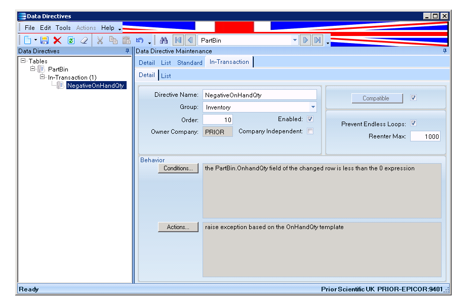

Interesting. It seems to me that since there is a transaction record but no change in partbin records, maybe there is a BPM interfering, probably a data directive on the partbin table. Can you verify?

your right i do have a bpm data directive on PARTBIN…the directive is to basically stop any bin going less than 0 quantity.
if i disable it and re-run the conversions?
ok its fixed.
  1. i disabled the BPM

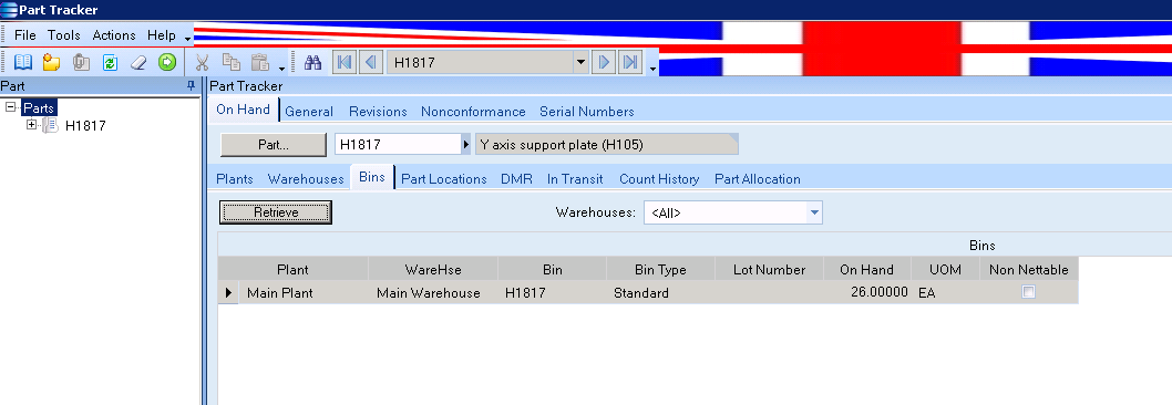

  2. i reran conversion 6430 and then got the below results…
