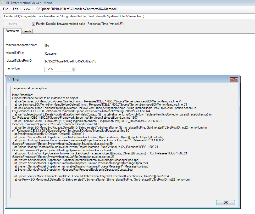

I am trying to delete a Memo by using the DeleteByID Method but I am getting an error. My code is below:
private void CallMemoAdapterDeleteByIDMethod()
try
MessageBox.Show("Call Memo Delete");
Int32 memoNum = Convert.ToInt32(neMemoNumber.Value);
string relatedToSchema = "Erp";
string relatedToFile = "Customer";
System.Guid relatedToSysRowID = System.Guid.Parse(tbMemoGuid.Text);
MemoAdapter adapterMemo = new MemoAdapter(this.oTrans);
adapterMemo.BOConnect();
bool result = adapterMemo.DeleteByID(relatedToSchema,relatedToFile,relatedToSysRowID,memoNum);
adapterMemo.Dispose();
} catch (System.Exception ex)
ExceptionBox.Show(ex);
MessageBox.Show("Memo Could NOT be Deleted.");
Error I am getting:
I have tried using the BL Tester Method to see what data I need to input and I’m not getting it to work either.

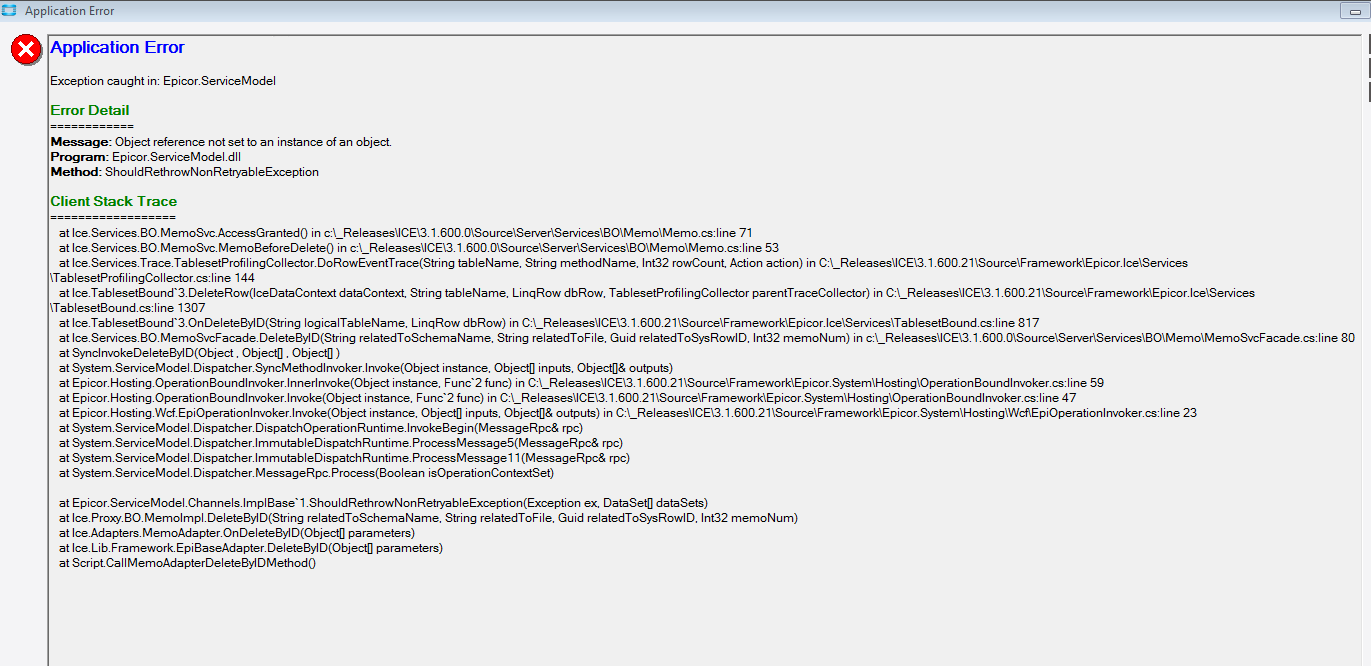

Unless someone has any other advice for me, I give up. I cannot figure this one out at all.
try
// Declare and Initialize EpiDataView Variables
EpiDataView edvGS_TrafficCustomerNotes = ((EpiDataView)(this.oTrans.EpiDataViews["GS_TrafficCustomerNotes"]));
// Check if valid EpiDataView Row(s) are selected
if ((edvGS_TrafficCustomerNotes.Row < 0))
return;
// Declare and create an instance of the Adapter.
// Declare and Initialize Variables
// TODO: You may need to replace the default initialization with valid values as required for the BL method call.
int intId = ((int)(edvGS_TrafficCustomerNotes.dataView[edvGS_TrafficCustomerNotes.Row]["Memo_MemoNum"]));
System.Guid relatedToSysRowID = System.Guid.Parse(edvGS_TrafficCustomerNotes.dataView[edvGS_TrafficCustomerNotes.Row]["Memo_RelatedToSysRowID"].ToString());
MessageBox.Show(relatedToSchema + ", " + relatedToFile + ", " + relatedToSysRowID + ", " + intId);
// Call Adapter method
bool result = adapterMemo.DeleteByID(relatedToSchema, relatedToFile, relatedToSysRowID, intId);
// Cleanup Adapter Reference
MessageBox.Show("Did not delete record");
This is what pops up in my messge box:
This is the error I get:
josecgomez
(Jose C Gomez)
August 16, 2019, 6:42pm
8
As I stated, DeleteByID is probably not implemented on that method. You need to do it the same way Epicor does it, do a trace on memo entry and follow it.

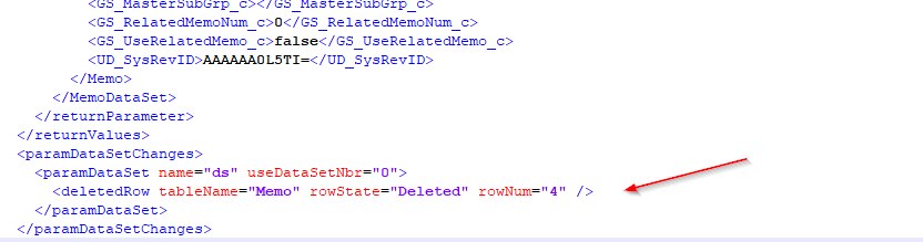

josecgomez
(Jose C Gomez)
August 16, 2019, 7:12pm
14
That’s only a little bit of the trace. You need to do a GetByID and then a delete with a full trace on so you can see what happens.
skearney
(Shannon Kearney)
August 16, 2019, 7:18pm
15
Okay, I launched the Memo and found my customer. Then I cleared my log and starting logging.
1st step I made a new one. Saved, clicked on another note, clicked back on the one I wanted to delete and clicked delete.

You aren’t showing the datasets in your trace, that’s where the changes happen. Run it with a full trace
skearney
(Shannon Kearney)
August 16, 2019, 7:22pm
17
josecgomez
(Jose C Gomez)
August 16, 2019, 7:26pm
18
ok if you look at the trace you’ll see that your last update has a parameter dataset change of RowState Deleted
So you need to mimic the same behavior, do a GetByID on the Memo, find the record that matches, mark that Row as Deleted then call update.
c#, delete-row
