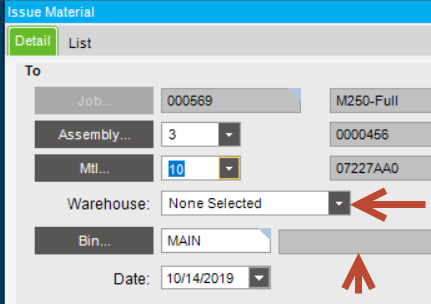

We’re looking to make a default for ToWarehouseCode and ToBinNum on the Issue Material menu.
I made a Post Processing BPM on Erp.IssueReturn.OnChangeToJobSeq. If both ToWarehouseCode and ToBinNum are both blank, it sets both to the default. This actually does seem to work when you hit save and perform the transaction, but the Issue Material GUI doesn’t reflect the change, instead saying “None Selected”. Usually I’d use oTrans.Refresh() to get the fields to populate, but it’s not enabled on IssueMaterial. Is there another way to force the 2 fields to get their descriptions on the Issue Materials menu?
