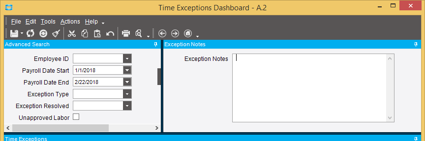

I have a dashboard with filters in one panel, a grid in another panel, and updatable fields in a another. If the use refreshes the dashboard while the updatable panel has the focus, none of the filters from the Search Panel are applied. Anybody have any ideas on how to fix this? This is very unintuitive. In this case, it takes 20+ minutes to load the dashboard when refreshing because it’s pulling all employees and not filtering.
Dashboard filters not working if field is updatable

My issue is that the filters applied to the BAQ results don’t work when refreshing the dashboard from an a textbox that is marked as updatable.
