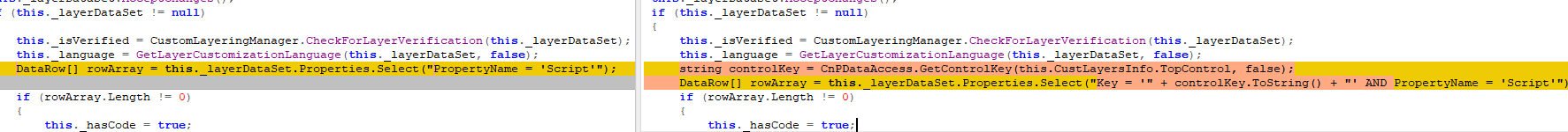

The main difference I see btw 2021.1 and 2021.1.8 is

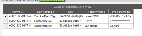

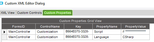

Its my understanding that it used to only query Script but now it also checks for the TopLevelControl GUID and I am not sure if that works well with dashboards because the Trackers TopMost GUID would be Ice.UI.Dashboard.DashboardTrackerViewPanel
It may be a bug. I am just making an assumption of what it could be - unsure of what it really does.
