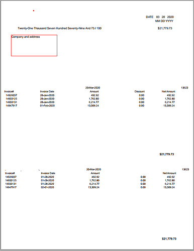

Our current check format is written in crystal and I am trying to tackle converting it to SSRS
The part I am struggling with is our format has 2 copies of the list of invoices for each check on the page - we detach the bottom portion for our records. See below
Any hints on how to do this in Report builder? I can get a second list of invoices, but only as a continuation of the matrix, not a separate table on the bottom part of the page.

I agree with Tim’s answer but if you are set on this, it will take some work
  1. You will need to make the check portion in the header instead of in the footer where it resides now (keep in mind SSRS has no absolute page bottom)
  2. Then you will have to duplicate the body and set it to a non-growing section 2 times.
  3. After that you will need to reset your max invoices per check to correlate to you newly sized sections.
    Note: it only seems like a few steps, by the time you get this working properly you can write 10 different report to store your printed check invoice inforamtion.
