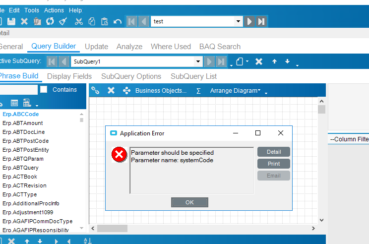

Just upgraded Epicor 10.2.300.14 to 10.2.400.5 When trying to create new BAQ this error show up and not letting me to create new BAQ. Old BAQ is not working either, i’m not sure what i’m missing. any ideas?
Message: Parameter should be specified
Parameter name: systemCode
Program: Epicor.ServiceModel.dll
Method: ShouldRethrowNonRetryableException
Client Stack Trace
at Epicor.ServiceModel.Channels.ImplBase`1.ShouldRethrowNonRetryableException(Exception ex, DataSet[] dataSets)
at Ice.Proxy.BO.BAQDesignerImpl.GetFieldList(String dataTableID, String schema)
at Ice.Adapters.BAQDesignerAdapter.GetFieldList(String tableId, String schema)
I am not seeing the issue on 10.2.400.10 - Is there a special table you are using? Please report it to Epicor, the more we have reporting it the more can fix stuff…
It was something related to the Conversion, some tables were having weird data and the Conversion Workbench Process for BAQs failed, i had to open a support ticket and they applied a Data Fix, re run the conversion and it passed, everything worked after that.
