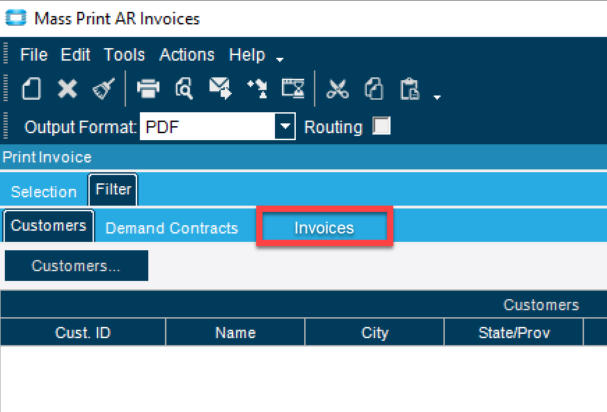

Lots of cool ideas on this thread, but is anyone else baffled that there is no Invoices filter in the Mass Print AR Invoices program? If we had something like this I think so many business cases I’m hearing here could be solved with Quick Searches and/or BAQ searches:
@TomAlexander I agree it’s puzzling this isn’t the first filter they developed for mass print AR invoices. It seems like there should be a simple solution to mimic an invoice group and use that group to reprint the invoices.
