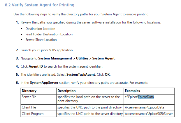

How or where do you specify the folder directories for the server and client during a new install? Do these get created during the install process?
During the install they were created. Below from the 905 install guide

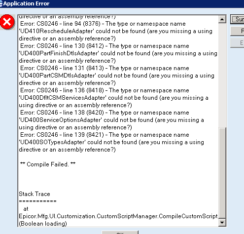

Do we need to also recompile our custom codes? We are getting the error message below. Is it possible that our server and client files are not stored at the correct default location?
I would download the upgrade guide and follow it for all of the mass recompiles that need to be done. Find this guide Epicor905_SPGuide_905702_SQL.pdf on EpicWeb and review section 8.3 – 8.8

The person that did the new install accepted all the defaulted prompts where it prompted to save the server and client files. So i’m not sure why it is still erroring if it should be pointing to the default location or where can i change where it defaults to find the server and client files within Epicor?

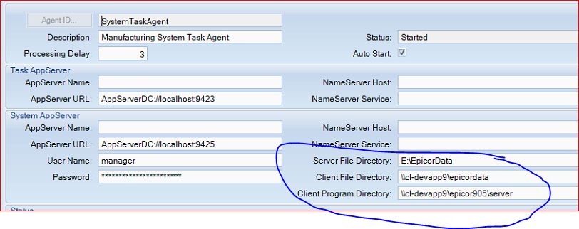

Do all of the section 8 recompiles and that will get you closer. In your task agent you can see the directories that were setup.
Where do we look in the task agent? Are you referring to in the management console? Also, do you have a separate client file location for customizations or do you put it in the default Epicor905\Client folder location?
