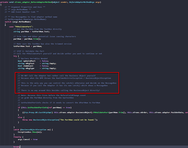

Its often the Adapter that has the MessageBox wrapped… The BO’s are silent and will output messages usually to an out variable or throw an exception… So by not using the Adapter you can sometimes get around it… Now if Epicor calls Update() and that calls 10 other methods, then it becomes much more difficult =)
Agreed, I only do it when I have to like in fast paced Packout where a Popup blocking your Handheld as you try to rapid fire through labels was a No =) Instead I played an error.wav and showed the message but the error.wav screamed “stop scanning, pull up Handheld and look at screen I need you to push something”
