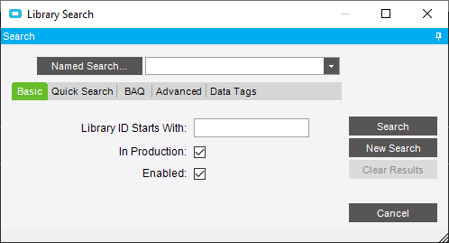

The above syntax worked correctly in my case. I had to include the AutoPostAP library as a reference in a different library. If you can’t find the library you are looking to reference make sure it fits the search criteria checkboxes:
Yeah, silly me, I was trying to add it as an Assembly Reference not a Library Reference, thanks !
