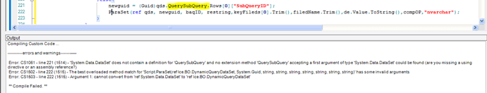

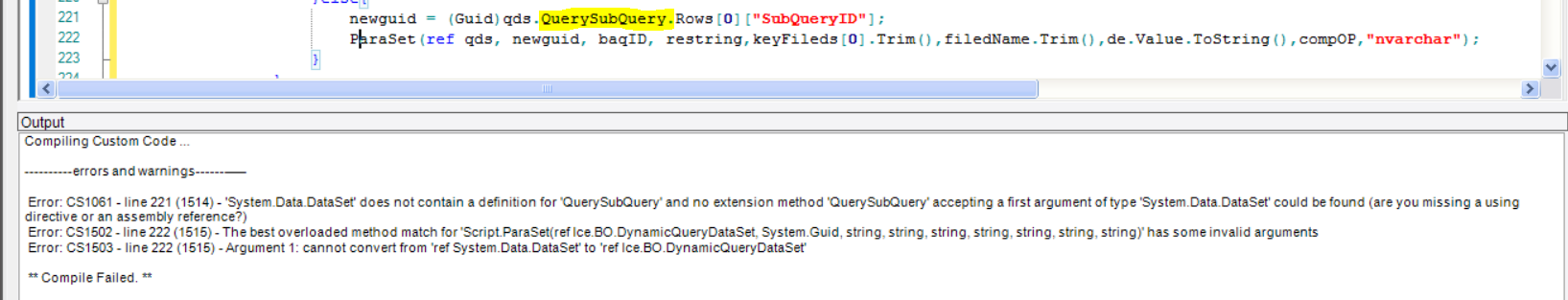

many thanks for your reply mate, really appreciate that, i have similar code for run dynamic query with multiple parameters, what i meant on my previous post is that the piece of code i uploaded using sub command within the void and class of using WCFServiceSupport that i need to replace as it error out on the new Epicor update, such as “QueryWhereItem” & “DynamicQuery” so what i have done, is just replace it with Tables[0] and it compile - i do not know yet if it going to function as it designed for or not- as i am just trying to fix the fails and it is not my piece of code, another example is this one within the new Guid line

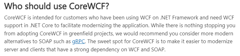

Epicor did use Core WCF.
Yep. Core WCF is a community project. From: CoreWCF 1.0 has been Released - .NET Blog
FYI: This will help with the simple syntax to resolve this issue.
