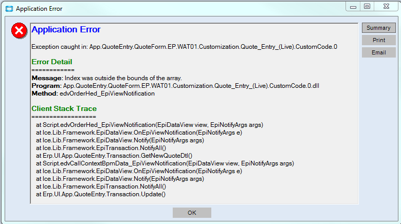

That now may actually be bad code in your edvOrderHed_EpiViewNotification on the UI Customization. What you got there?
Do you mean BPMs on the OrderHed or customisations on the form itself?
That Error is coming from the Customization Form. Looks like the BPM Executed just fine.
Here is the code attached there. Not written by me I hasten to add. I think it was a third party subcontractor.

I think I found the problem. the customisation code uses BPMContext Data character01 as well. I took it out of the Reference BPM and the error went away. Thanks Haso, you’re the best!!
Hi guys, I seem to have hit a problem. I thought this worked but in our live system where the order qty and Character03 are populated by the configurator, the BPM is not formatting Character03. Does it recognise the configurator has made an update? Or does the configurator populate the field after the BPM? I am getting the messages so I know the BPM is firing but Character03 is exactly the way it comes from the configurator.
@ckrusen @hkeric.wci
It’s possible the BPM is doing it’s job, but the UI is lagging behind the updated data.
Have you run a trace to see the orde of the calls, and what data is being changed by each?
A BPM usually carries 2 row records in most cases… The Unchanged row (aka the historical, previous row) and Changed Row (with the proposed values). Wherever you are assigning Character03, make sure you are assigning it with the value of the Changed Row… RowMod of U or A.
If you gave us more code to give us more context, we can see what your doing.
The code from post #29 has Character01, and ShortChar01
Did you update them both to “03” ??

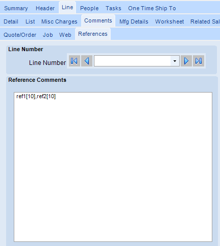

This is the process from the start as I have it now. Character03 is populated by the document rules from the configurator like this;
switch (Context.Entity)
case "QuoteDtl":
QuoteDtl.LineDesc = Inputs.fbPartNumber.Value;
QuoteDtl.PricingQty = Inputs.decQty.Value;
QuoteDtl.SellingExpectedQty = Inputs.decQty.Value;
QuoteDtl.OrderQty = Inputs.decQty.Value;
QuoteDtl["Number01"] = Inputs.decQuoteCost.Value;
QuoteDtl["Number02"] = Inputs.decGlobalMaterialCost.Value;
QuoteDtl["Number03"] = Inputs.decGlobalLabourCost.Value;
QuoteDtl["Number05"] = Inputs.decScrapCost.Value;
QuoteDtl["Character01"] = Inputs.edBody.Value;
QuoteDtl["Character03"] = Inputs.edReferenceComments.Value;
QuoteDtl["CheckBox03"] = Inputs.cbNonStandardProduct.Value;
if (Inputs.cbNonStandardProduct.Value)
QuoteDtl.OriginalPartNo_c = Inputs.edDescription.Value;
break;
This works and the references are populated on the quote form.
The BPM fires and everything is good so far
However the values from the BPM are not being saved to the quote, character03 would stay the same anyway but character04 is empty
Incidentally the reason for the two different string values is Character03 will be printed on the quote as it is more tidy and compact, character04 is in the format required for our label printer.
