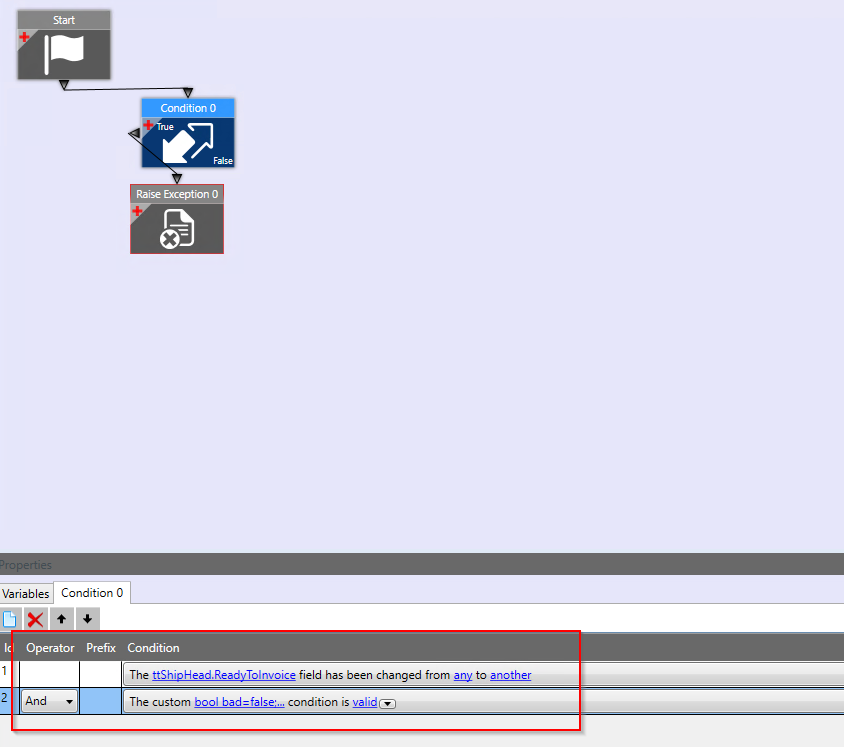

You’ll have to write that as a LINQ query in Custom Code use a Custom Code Condition and then use the Field Changed from X to Y as another condition (ReadyToInvoice)
See below
Like this (note I attempted to translate your SQL query to LINQ not sure if I hit the mark or not but you’l get the idea.

The ReadyToInvoice is the trigger on the record to file the BPM.
