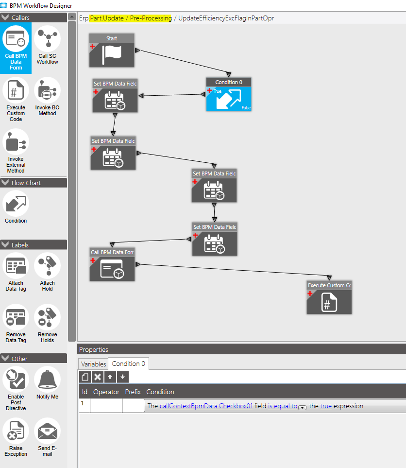

am i correct saying that you are triggering the relevant BPM when clicking a button on UI form, then when the BPM run will go through a condition, to call the BPM Form ?

i am very interested to see your code of doing it this way, as my way is triggering a callcontext variable and changing the relevant RowMod to Update status, when clicking my button, then these two will trigger my BPM and its form, my code on script editor screen of Part BO is:

this simply will trigger the following BPM which has a call for a BPM Form:
