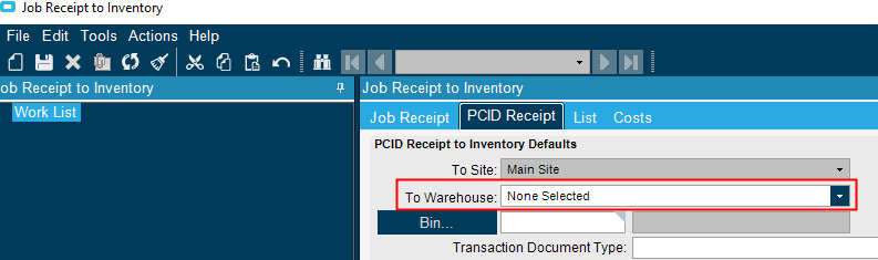

I am trying to create a BPM to default the “To WareHouse”
In Method Directives- chose the below mehtod directive
Here is the design created in preprocessing and enabled. but its not working. Kindly guide me where I am doing the mistake.

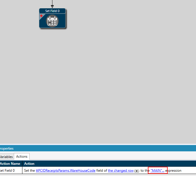

Please anyone can review the above BPM.

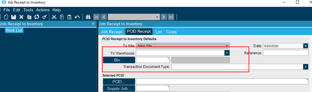

I am not sure Alex, the reason I chose preprocessing is the moment i open the module "job receipt to inventory’ we can update the data. I am not clicking - File -> New option. The “New” icon is also greyed.
The moment we open the module - The “To Warehouse” should be populated with the default data.

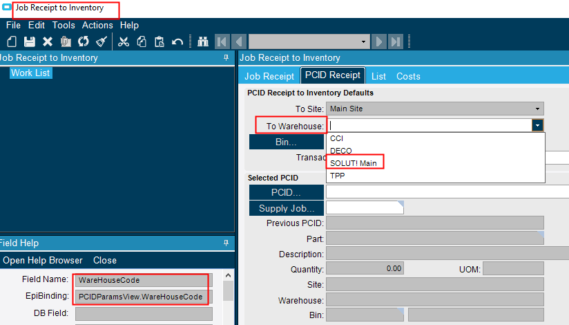

Make sure the expression in the Set Field Widget is using the “Code” and not the “Description” that shows in the dropdown.

FWIW - I tried doing what you were trying to do - but for the Receipt Warehouse, and not the PCID warehouse. And I had zero luck. I put in Show Msg widgets in several different BPM’s, both Pre and Post Proc. I could see it the value but was never successful in stetting it.
