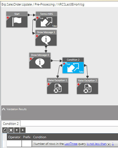

I’ve got a pre-processing BPM on SalesOrder.Update, which has a condition to check if a specific TermsCode is used. If it is, then I’d like the BPM to see if a UD field (Customer.LastThree_c) is empty. If it’s empty, I want to raise an exception.

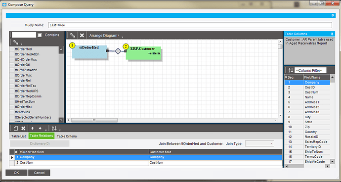

Jackpot!!! Thank you. The “Number of rows in the designed query” worked great once I linked the OrderHed temp table to the Customer table.
By the way - I didn’t see “Invoke BO” in the callers section of the Pre or Post-processing, just “Invoke External Method”. We’re on 10.0.700.4. Could it be lurking elsewhere?
When I add criteria to the query, the BPM has a compilation error of '“An object reference is required for the non-static field, method, or property”.
Without criteria to the query, it works fine. What’s causing the compile error? I’ve created the same query in a BAQ, and it runs OK with a hard-coded CustNum instead of taking it from the temp table. I’ve added Company and CustNum fields in a message box, and they are getting passed from the temp table, so it should be getting to the query.

I’ve got my BPM set up so the first Condition looks for TermID=“NRS”, and if true, goes to the next condition with the query. This should skip the (possibly intensive) query on the majority of orders, no? The query is drawn with an inner join (it started off that way, then stripped the name in the “join” box, and doesn’t give me an option to change it.
@danbedwards - I changed the query criteria to LastThree_c MATCHES “%” constant with the intent of giving me a row when the field is not empty. The vast majority of our records have that field empty. Is this an effient way of doing it?

Fixed it!!! Replaced MATCH "_%" with >= "0" and it works! It seems odd to use > and numbers in a string type field.

My BAQ test doesn’t return any null results, so I wouldn’t expect that to work. Epicor made the field empty when no data is in it (on a new record, or when I’ve deleted the numbers and saved).
I modified my query MATCH to “_%”, thinking I’d catch all instances when something is in the LastThree_c field. It didn’t work - it always returns false, regardless of the LastThree_c field being empty or containing data.
I tried MATCH “[0-9]%”, but that didn’t return a row either.
If I change the query MATCH to “123”, I get true when the customer has 123 in the LastThree_c field, and false if it’s 456 or empty (so that works).
