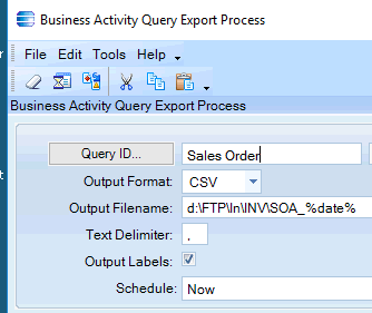

Has anyone tried running the BAQ Export Process via a batch file? I am trying to schedule one to run but I need to include the yyyymmdd to the .csv it creates. I know you can add the date stamp to the file name via code in a batch file but I’m not sure how to run the BAQ export process first to get the file to then add the date to. Perhaps a different option then what I’m thinking can work? I have tried several different things in the actual BAQ export process screen without any luck.

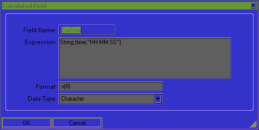

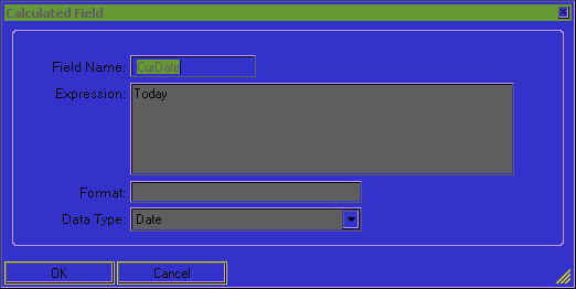

Also, I sometimes include date/time stamps right in the BAQ/CSV.
e.g.
A pre-proc BPM on the BAQ export process could alter the file name sent to the BAQ Export. I used to use this trick in V8 to pass “parameters” to the BAQ.
This following link shows a little of it in V8
BUT don’t get wedded to it as the BAQExport method doesnt exist in E10
Calvin this is actually for version 9 so maybe your idea would work?
