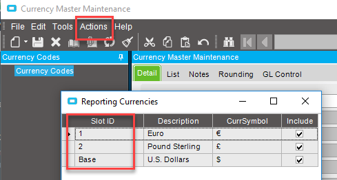

You need to check your reporting currency setup in Currency setup.
And then you need to check your currency exchange rates.
Rpt1OrderAmount will be in whatever currency is in rpt currency slot 1, and it will be $100 * CurrExchRate record for that currency and USD, for that date, etc… Depends on how you have your exchage rates set up.
In general, once you set up a reporting currency, the system will go back through all subledger financial transactions and convert the standard value fields to RPTCurrency values and plug them in to the correct fields (they mirror the standard value fields).
Not to be confused with the ‘Doc’ fields as they are for transactions that can happen multiple currencies like Orders and Quotes. (eg, the Customer’s Currency is Euros, but the base company currency is UK Pounds, so the ORderAmount will be in UK Pounds and the DocOrderAmt will be in Euros).
The system will then maintain these fields moving forward, for every transaction.
These do NOT affect the GL, which is ALWAYS in your base currency.
