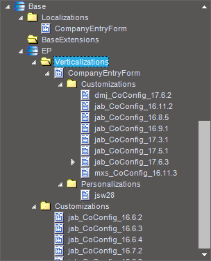

Verticalization - fourth layer - This layer was designed to be used by Partners or CSG. Implementation logic is a little odd and this layer is not as useful as it could be. I believe this loads against a Parent layer (not 100% sure) and it loads based on the presence of a Verticalization code in the DB and is not company specific (this is where the logic is a little odd as it really should be company specific).

Maybe this needs a new topic, but could your comment “implementation logic is a little odd” be behind our troubles with a form that has a CSG verticalization? This was provided for us to cover some removed functionality in the transfer from 10.1 to 10.2, and since then we have never been able to get any customization to reliably appear for that particular screen.

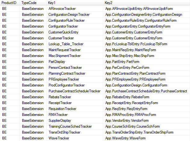

Thank you, gentlemen, for the insight. In my case, the Base Extension appears to be what @Rich had described earlier as “used by Epicor to make a ‘tracker’ from a data entry form”, which may explain why I cannot simply delete it outright.
Thanks for the extra details, @hkeric.wci. Looks like my earlier assumption was incorrect. The base extension, in my case, is the “PartDisplay” BE on the Part Maintenance form (shown above in your list of BEs). So, it appears that this is an out-of-the-box configuration on that form (and hence, cannot be removed).
Bill, that’s correct. Part Display is an out-of-box tracker that mimics the look of Part Entry. Whereas Part Tracker has a few more tabs and more information.

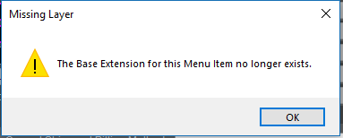

We recently upgraded from 10.1.500.10 to 10.2.200.15. We previously used a context menu based on CustCnt.Name that included a menu item for Customer Contact Entry. Now, if that context menu item is selected, the application throws the following message:
Based on what I’ve learned from this thread, I am now concluding that Customer Contact Entry (Erp.UI.App.CustomerEntry.ContactEntryForm, perhaps?) was simply a base extension that was removed by Epicor sometime after 10.1.500.10. Could someone confirm that my conclusion is logical? And if it is, can someone tell me where in release/update documentation this type of change can be found?
