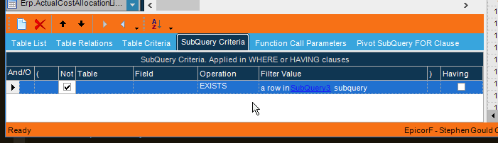

There is EXISTS operation in criteria, and NOT checkbox

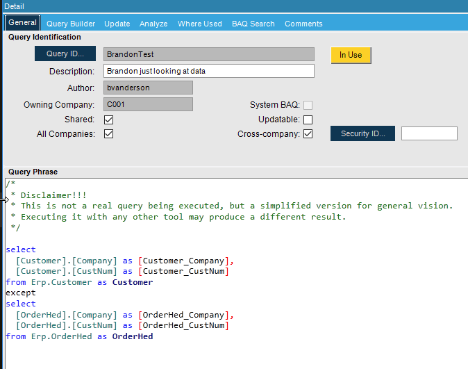

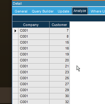

You can also do an except query. You would put your customers on the top level, then the orderHead on the except level, and it will give you a list of customer numbers that don’t have orders. Then use that to get what you need on the next level up.
That worked. Thank you Banderson!

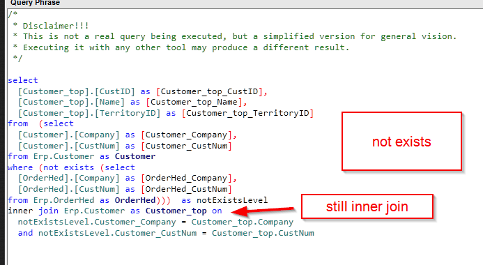

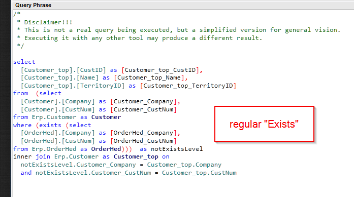

@Olga, for grins and giggles I tried the not-exists, and that just returned nothing. I don’t believe that works as expected. Or am I doing something wrong there?
That would be sad.
I have not check recently, but you can looks what query is generated in the server using trace flag for BAQ statement.
