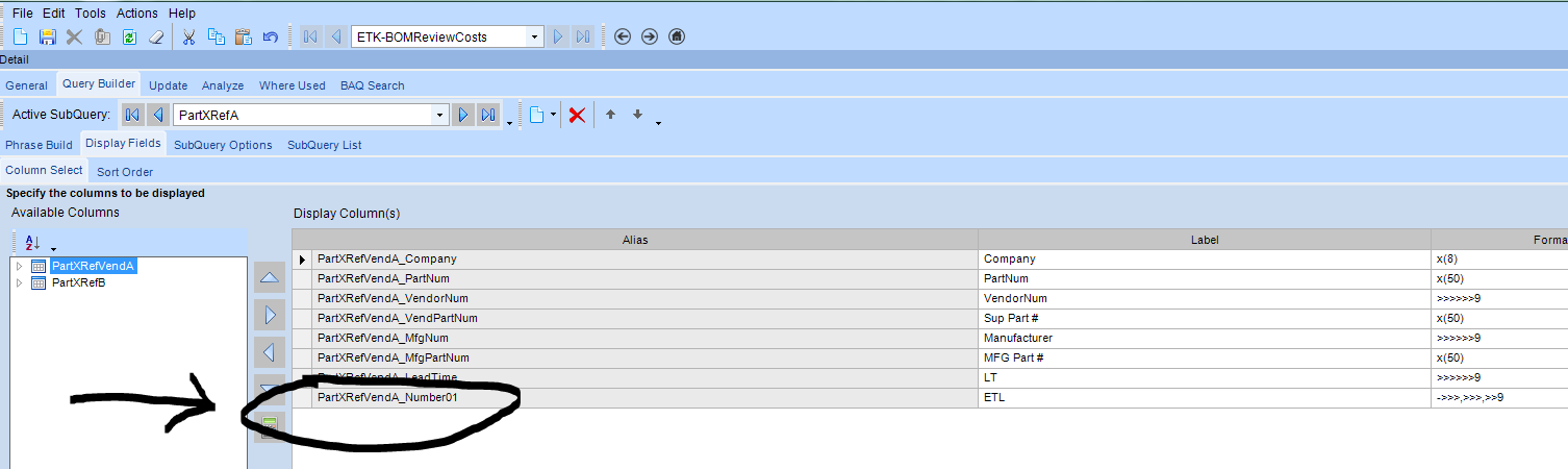

Ken,
I imported your BAQ an d received the below error message when I tested it.
Severity: Error, Table: , Field: , RowID: , Text: References to inaccessible tables detected:
subquery ‘PartXRefA’, table ‘Erp.PartXRefVend_UD’ with alias ‘PartXRefVendA_UD’
I am a newbie to writing and debugging code so if you could point me in the right direction, I would appreciate it.
Thanks.
Jim
There is a UD field in this query. You don’t have that field in your database.
Thanks Brandon. I am looking for it and cannot for the life of me, find it. I would assume to look in PartXRefVendA but I do not see a UD field there but I have known to be blind.
I’ll probabably have to refer to @knash this one I guess. It’s not in the query that you posted. I don’t have the query in my system to poke around with it.
Does the error show when you analyze it? Only when you run it? It’s not a pop up right?
Brandon,
The query is the one knash uploaded above called ETK-BOMReviewCosts.baq from Nov '18. When I analyze it, I get the below Query Execution Message:
Found it in the code. Now I just need to go find it in the Query Builder and remove it.
left outer join (select
[PartXRefVendA].[Company] as [PartXRefVendA_Company],
[PartXRefVendA].[PartNum] as [PartXRefVendA_PartNum],
[PartXRefVendA].[VendorNum] as [PartXRefVendA_VendorNum],
[PartXRefVendA].[VendPartNum] as [PartXRefVendA_VendPartNum],
[PartXRefVendA].[MfgNum] as [PartXRefVendA_MfgNum],
[PartXRefVendA].[MfgPartNum] as [PartXRefVendA_MfgPartNum],
[PartXRefVendA].[LeadTime] as [PartXRefVendA_LeadTime],
[PartXRefVendA_UD].[Number01] as [PartXRefVendA_Number01]
from Erp.PartXRefVend as PartXRefVendA

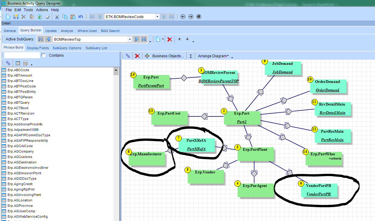

Thanks Ken. I am not sure if it is 10.2.100 or something else because see the below screen shots. I am getting the error when I test or analyze it but it is not showing in the Query Builder display. What would you recommend using to edit the SQL if I were to export it, fix the code and then import it?
@knash is your database an uplift from E9?
@jimphillips, it looks like this is going to be a business specific BAQ. So you would use this as an example to build your own.
I would remove the following from the top level query. See what happens then. The BAQ has a lot going on.
a few calculated fields may need to be removed as well.
