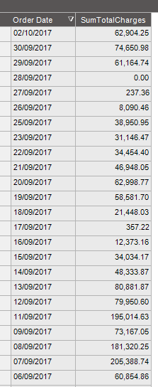

I have the start of the baq - which sums all orders grouped by date to give a total for each day
I want to then take each days Total Daily sales add the next 21 days Total daily sales and divide by 21 to give the average.
This seems like an impossibility to me in a baq - something easily achieved in excel. As you can see below

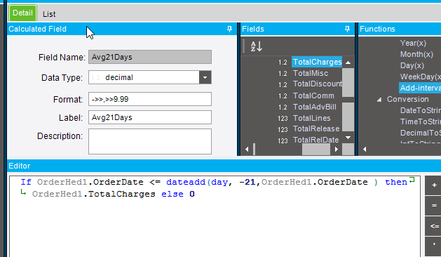

Hi Carla,
The easiest way I can think of is to create three different calculated fields. They would look like:
If (salesDate <= your_days then salesAmt else 0)
where your days is 21, 3 months, or one year. Do this in a subquery then sum them up in the Main query.
Mark W.

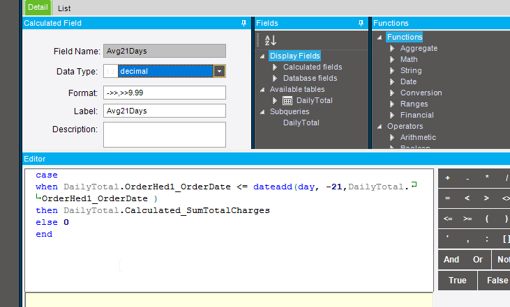

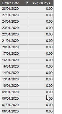

Thanks Mark- I tried your advice like below but it doesn’t compile

You could also try
CASE WHEN … then … else end
Sorry Carla, I didn’t give the exact syntax but was just giving a strategy to get there. I like @aclements suggestion for using a case statement. Also, make sure your ranges do not overlap. You may want to use weeks to make it easier. Zero to three weeks; four weeks to 12 weeks and 13 weeks to 52 weeks.
Thankyou- could you expand a little on this solution im not entirely sure …
