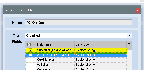

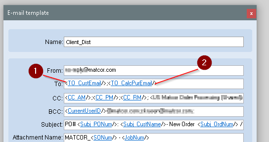

For example, our APR for OrderAck has two report fields in the “To:”
With #1 being
and #2 being:
both of those are derived by the RDD - It determines the value based on whetehr certain fields are populated or not. There could be a bug where that field gets calculated wrong.
Duplicate the Report Style, and then add the field you’re using for the “To:” to be displayed on it, and see if it appears as a single (and valid) email.
