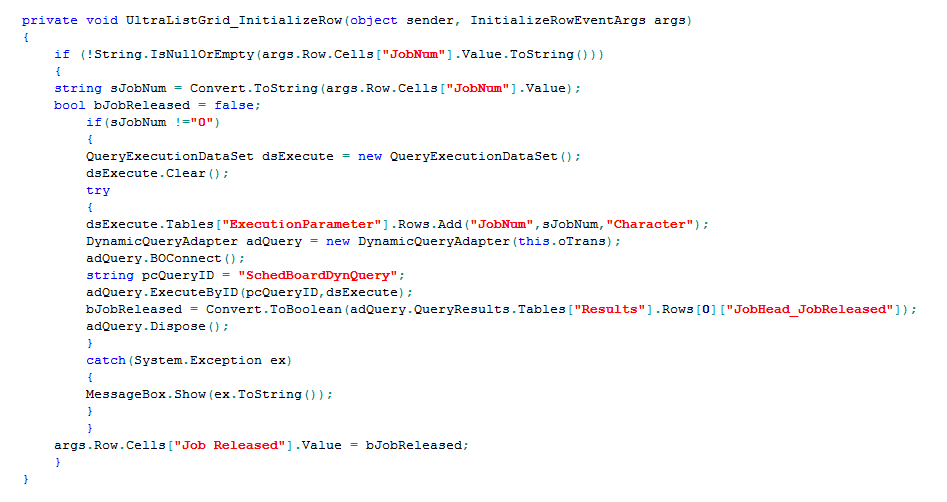

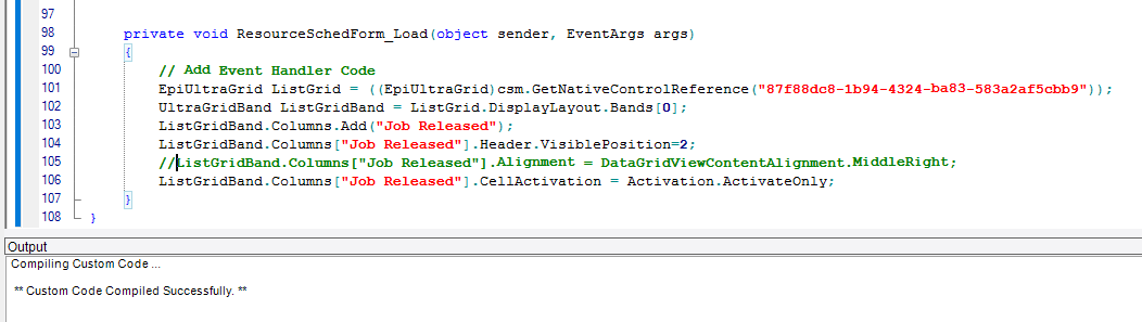

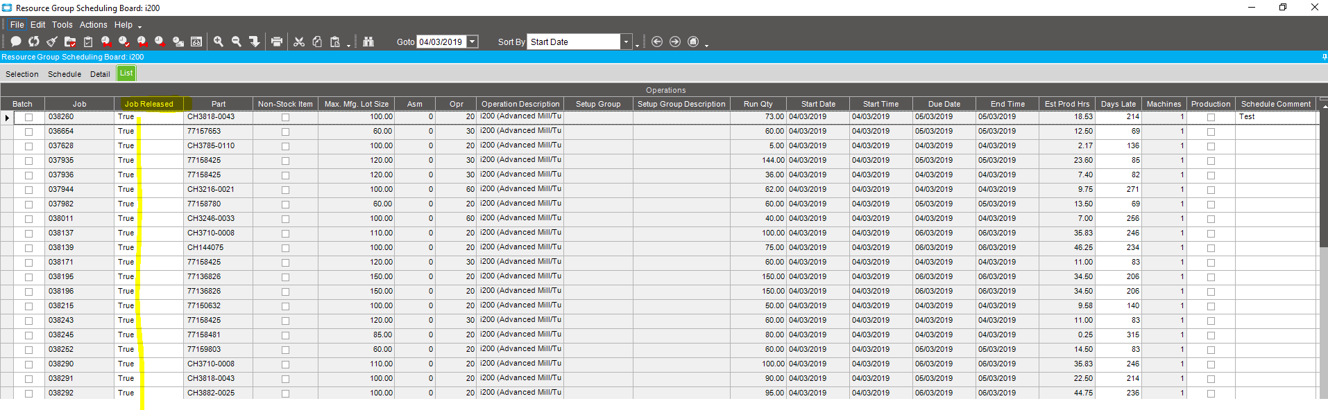

This is what I would do. It takes 10 lines of code to add any column from other tables to that grid. I created a ui customization just to repurpose one of the hidden columns. I also created a BPM that populates that column with the information that I want. On my example, I wanted to display the JobHead.JobRelease flag.
