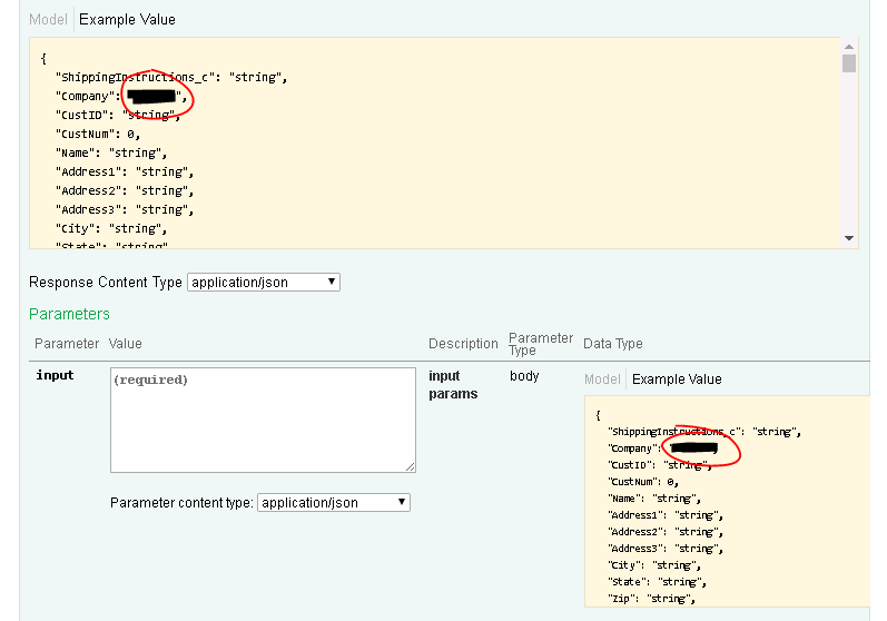

Hi all,
I am trying to import new customer using REST API. I am not able to change the company name.
It takes a default company name only. Even I am passing different company name that exists but it inserted into the default company only.
Can anyone please help me.
Thanks in advance.

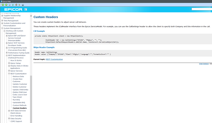

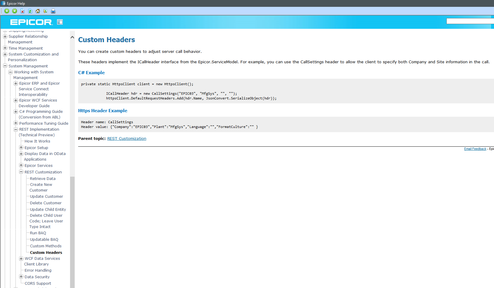

There is also documentation in the Epicor Help

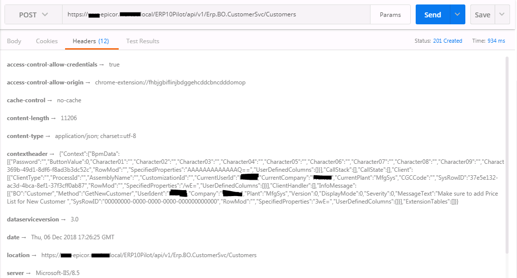

For me on 10.2.200, I had to use this format:
