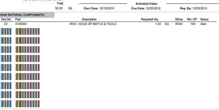

The preview of the report not only doesn’t show the Expected Quantity field, but it also takes the single barcode strip for each field with a barcode and creates 7 additional copies within the Raw Material Components section of the report, which does not occur on the standard JobTraveler report we regularly use.
Is anyone able to help me determine why I am not able to get the Expected Quantity field to show on the report, as well as why there are numerous unnecessary barcode copies being added?
