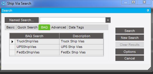

How do I add a BAQ search to this area?
Write a BAQ that returns the Primary Key of the ShipVia Table ShipViaCode.
Does the BAQ just auto populate in that field, or do I have to tell it to show up there? If I have to tell it, how?
@josecgomez SO i have the query wrote returning the ShipViaCode, but I still lack how to put this so it shows up.
It should just ShowUp… Go to the BAQ Like property in the BAQ and move the fields over to the right.
You are correct. I didn’t go to the BAQ Search tab and move it over. Thanks for pointing that out.
