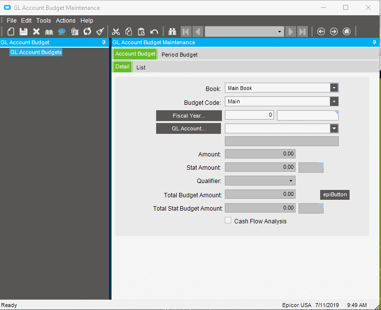

private void epiButtonC1_Click(object sender, System.EventArgs args)
oTrans.ValidateKeyField("1100|00|10");
oTrans.KeyField="1100|00|10";
So if you can get via your dropdowns a valid GL Account, then calling the above code will fill the box and make it do what you want.
Yes that works! Can you filter that view that it shows? or would I have to make my own view, and getRows?
What view?
On the period budget tab
What do you want to filter?
I want to filter it main and 2ndhalf

Search around for BAQ combo drop downs. You can make the BAQâs (with parameters to filter) to link to the drop downs, then make a button to link the lines of code that Jose gave you to fill in the actual control.
Like it shows 12 rows because of 12 fiscal periods, when 2nd half is selected I only want it to show 6. I didnât know if I could filter out epicors base control or if I would have to make my own essentially.

Making 6 ReadOnly is what I was meaning, which I figured out how I can do that. Is there a way to add a manual column onto a a ultragridâs epibinding? I would like to calculate something and add that column at the end of it where itâs being generated by me and not the datasource if that makes sense.
this will show you how to add a header, then a column, then just leave it unbound and you can loop through the grid and set your values.
