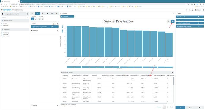

For users that want to see the transaction details behind an edd view there’s a transaction panel which you can get at like so. If you select data points in the chart it will filter the transaction details down to the records behind the selected data points.

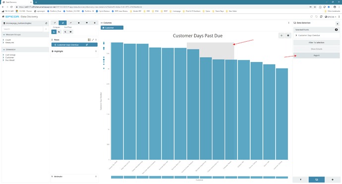

What you all need and we have not yet done is an export option on that transaction details panel so you can export the full details out to excel. That’s coming but not in yet. We have export for selected data point data behind the chart in right now which you can do by selecting one or more data points in the chart then clicking the export option in the data selection panel, but it’s the data in the chart not the raw transaction details which is I think what’s missing that most of you need.
